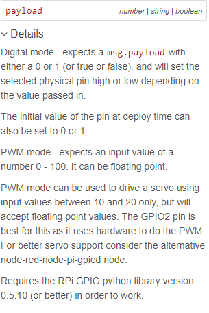

The first one here? Can you try to find more information about rpi-gpio out from the interface?
The issue with a lot of these plugins/libraries are that they were designed without the proper abstractions. They become heavily Pi specific rather than generic which makes even creating a compatible library a mess. For example, PWM and GPIO are very different and should not be in the same function.
If we were to create a library for node-red, you may have to rewire your flows since we would not mix these two operations together.

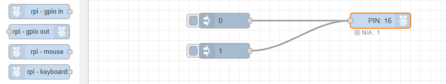

With the RPi GPIO nodes, I drop one on the canvas, then select from the graphic which pin that node will apply to in this flow. Then send it a 1/0 to control. Same thing with the Read/input version, but it sends a message in the flow upon state change.
