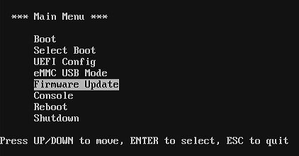

The latest firmware for:
This firmware update include the following features:
- gzip compressed boot.bmp bootup images
- intelligent boot device detection for boot logo and ini load
- Wake-on-LAN via
sudo ethtool -s end0 wol g
- u-boot to version v2025.07
- preliminary support firmware capsules

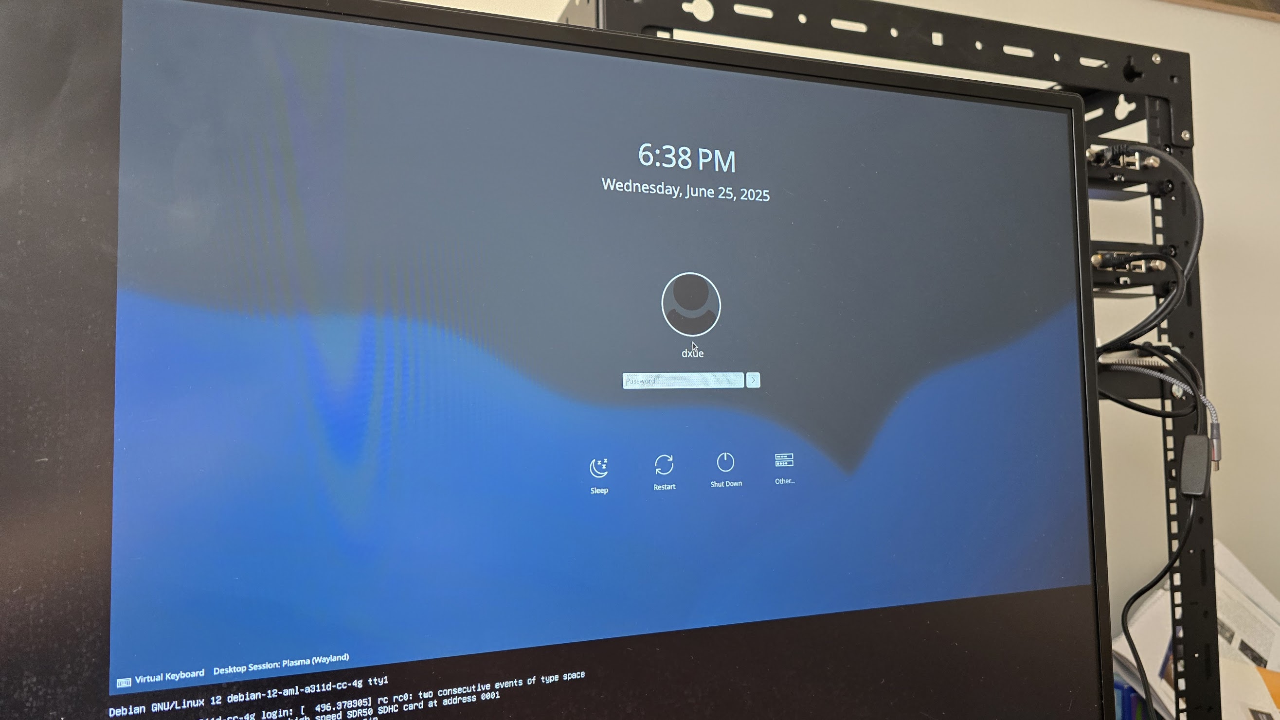

It has been tested against the following distributions:
- Fedora 42 - Fedora-Workstation-Live-42-1.1.aarch64.iso - works
- Debian 12 - debian-12.11.0-arm64-DVD-1.iso - network driver missing during install
- Debian 13 - debian-testing-arm64-DVD-1.iso - graphic install is not working but serial works
