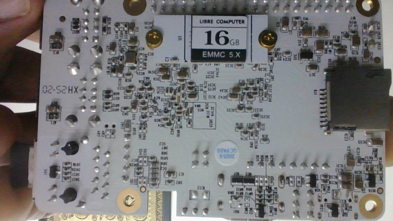

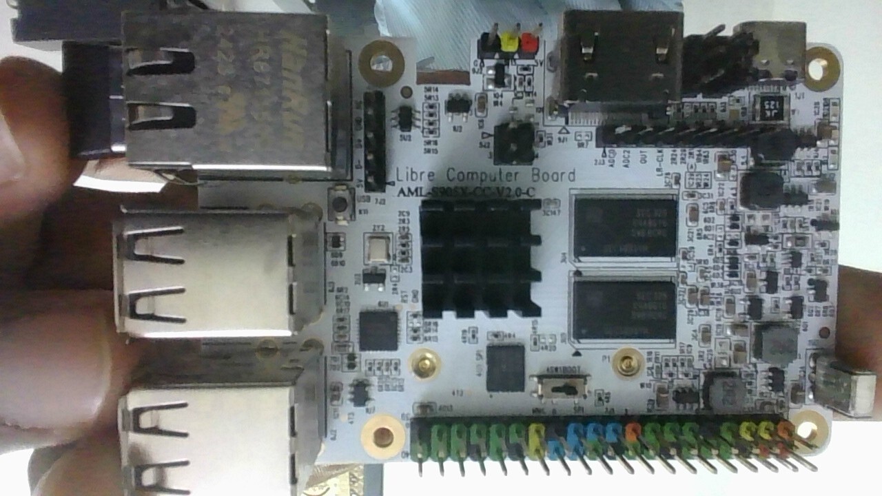

A picture of the module top and bottom and the board’s bottom side? What bootloader are you running? It is our bootloader or Armbian’s?
I just connected to USB using the flashing cable. Proceeded with same procedure mentioned in article. But not detect eMMC. I try to flashed eMMC from another recent version of LePotato and install in this also not boot.
This module is designed for V2 only. There’s no LDO on it to support V1. The ones that support V1 has one or two black dots on it.
