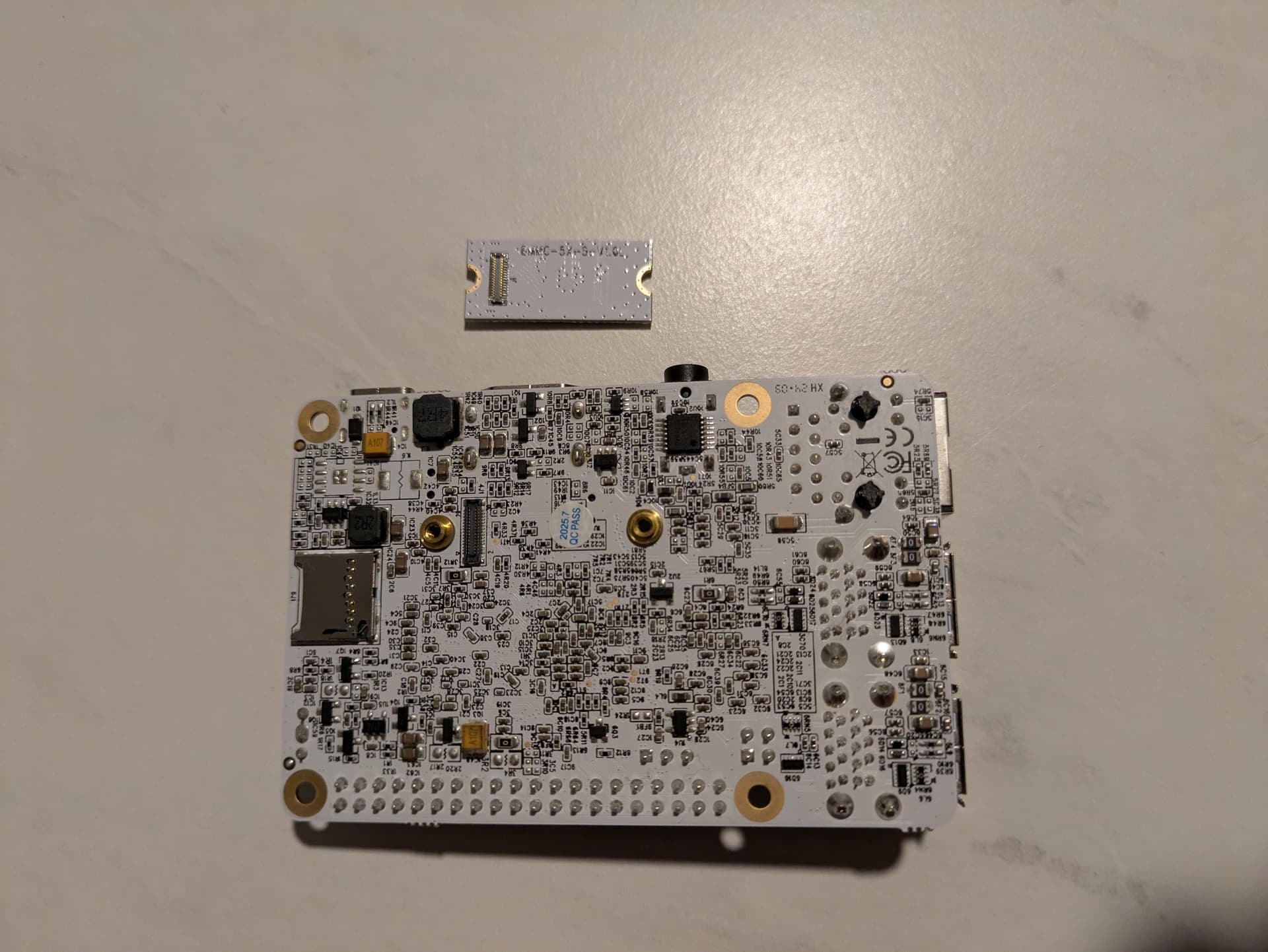

Can you provide photos of the board connector and the eMMC module?
What would cause the eMMC not to work in U-Boot, but work fine in Linux?
Is Linux using HS200 and U-Boot is trying to use another mode?
Or is it because Linux is using 8 data lines for the eMMC, while U-Boot is using 4 data lines for eMMC and the other 4 data lines for the SPI NOR?
Not sure about the default in the u-boot driver but it could potentially be 8 lines in u-boot and 4 in Linux. Please have them ship you another module.
