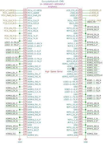

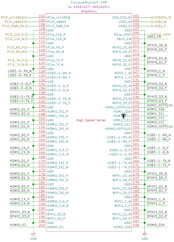

Raspberry Pi Compute Module 5 Connector B
Libre Computer Cottonwood Compute Module
  • 1, 3, 5 USB OTG with ID
  • 9 PCIe Reset Active Low
  • 11 VBUS_EN / Composite Video for CM4 Compatibility
  • 15, 17, 21, 23, 27, 31, 33, 35, 39, 41 MIPI CSI 0 4 Lane
  • 43, 45, 47,49 HDMI 1 HPD, I2C, CEC
  • 51, 53 HDMI 0 HPD, CEC
  • 57, 59 PCM CLK/SYNC, USB 3 RX on CM5 IO
  • 63, 65 USB 2
  • 69, 71 PCM OUT/IN, USB 3 TX on CM5 IO
  • 75, 77 MIPI DSI 1 D0
  • 81, 83 MIPI DSI 1 D1
  • 87, 89 MIPI DSI 1 CLK
  • 93, 95 MIPI DSI 1 D2
  • 99, 100 HDMI 0 I2C
  • 96, 94 MIPI DSI 1 D3
  • 90, 88 HDMI 0 CLK
  • 84, 82 HDMI 0 TX0
  • 78, 76 HDMI 0 TX1
  • 72, 70 HDMI 0 TX2
  • 66, 64 GPIOX_14/GPIOX_15, HDMI 1 CLK on CM5 IO
  • 60, 58 SDIO D3/D2, HDMI 1 D0 on CM5 IO
  • 54, 52 SDIO D1/D0, HDMI 1 D1 on CM5 IO
  • 48, 46 SDIO CMD/CLK, HDMI 1 D2 on CM5 IO
  • 42, 40 CSI 0 CLK B / HDMI0_RSVD, USB 3 TX on CM5 IO
  • 36, 34 Stereo Right, USB 2 on CM5 IO
  • 30, 28 Stereo Left, USB 3 RX on CM5 IO
  • 24, 22 PCIe TX
  • 18, 16 PCIe RX
  • 12, 10 PCIe CLK
  • 6, 4 PCIe Power / PCIE Wake
  • 2 PCIe Non-Posted Request

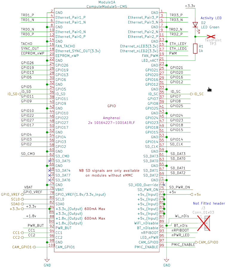

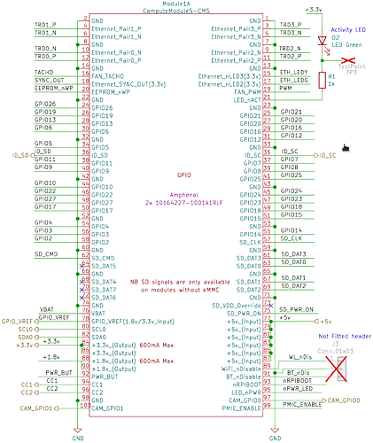

Raspberry Pi Compute Module 5 Connector A
  • 3, 5, 9, 11 Ethernet PHY MDI 3/2
  • 15, 17 Ethernet LEDs
  • 19 PWM for Fan
  • 21 VDDEE LED Green, Activity LED on CM5 IO
  • 25, 27, 29, 31 40P GPIO Header
  • 35 ID I2C Clock, 40P GPIO Header
  • 37, 39, 41 40P GPIO Header
  • 45, 47, 49 40P GPIO Header
  • 51, 55 40P GPIO Header
  • 57, 61, 63, 67, 69 SD CLK, D3, D0, D1, D2 (Second MMC Channel, CM5 Lite)
  • 73 SD Voltage Override, NC on CM5 IO (For SDIO IO Voltage Control)
  • 75 SD Power On
  • 77, 79, 81, 83, 85, 87 5V IN
  • 89, 91 GPIOX_12 / GPIOX_13, NC on CM5 IO
  • 93 USB MaskROM Mode
  • 95 VDDAO LED Red, Power LED on CM5 IO
  • 97 GPIO / IR Input (Wake Capable), CSI_GPIO on CM5 IO
  • 99 GPIOX_17 GLOBAL_EN, CAM_GPIO1 on CM5 IO
  • 100 nEXTRST External Reset Active Low
  • 96, 94 SARADC CH 3 / 2 (0 - 1.8V), CC1 / CC2
  • 92 GPIOX_7, Power Button
  • 90, 88 AO_1V8
  • 86, 84 AO_3V3
  • 82, 80 I2C (3.3V), CSI 1 / DSI 1 I2C on CM5 IO
  • 78 GPIOA_VIO (Sets the Voltage on GPIOA Bank), GPIO_VREF on CM4 IO
  • 76 SD Detect, VBAT on CM5 IO
  • 72, 70, 68, 64 SPI NOR Access, NC on CM5 IO
  • 62 SD CMD
  • 58, 56 I2C AO, 40P GPIO Header
  • 54, 50, AO GPIO, 40P GPIO Header
  • 48, 46, GPIOA, 40P GPIO Header
  • 44, 40, 38 SPI B, 40P GPIO Header
  • 36 ID I2C Data, 40P GPIO Header
  • 34, 30, 28, 26, 24 GPIOA, 40P GPIO Header
  • 20 SPI NOR Write Protect Active Low, EEPROM Write Protect Active Low
  • 18, 16 UART TX / RX, SYNC Out / Tach for Fan
  • 12, 10, 6, 4 Ethernet PHY MDI 0/1
