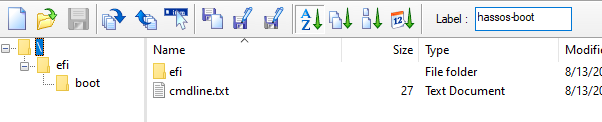

I took a look at it using WinImage and there was only one partition available to look at:
So I’m not sure how to just write the boot partition; the thought I had was write one out and delete all but the boot so I took a look with fdisk and two things stood out. It’s listed as EFI and fdisk complained about the table size mismatch:

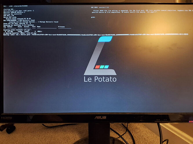

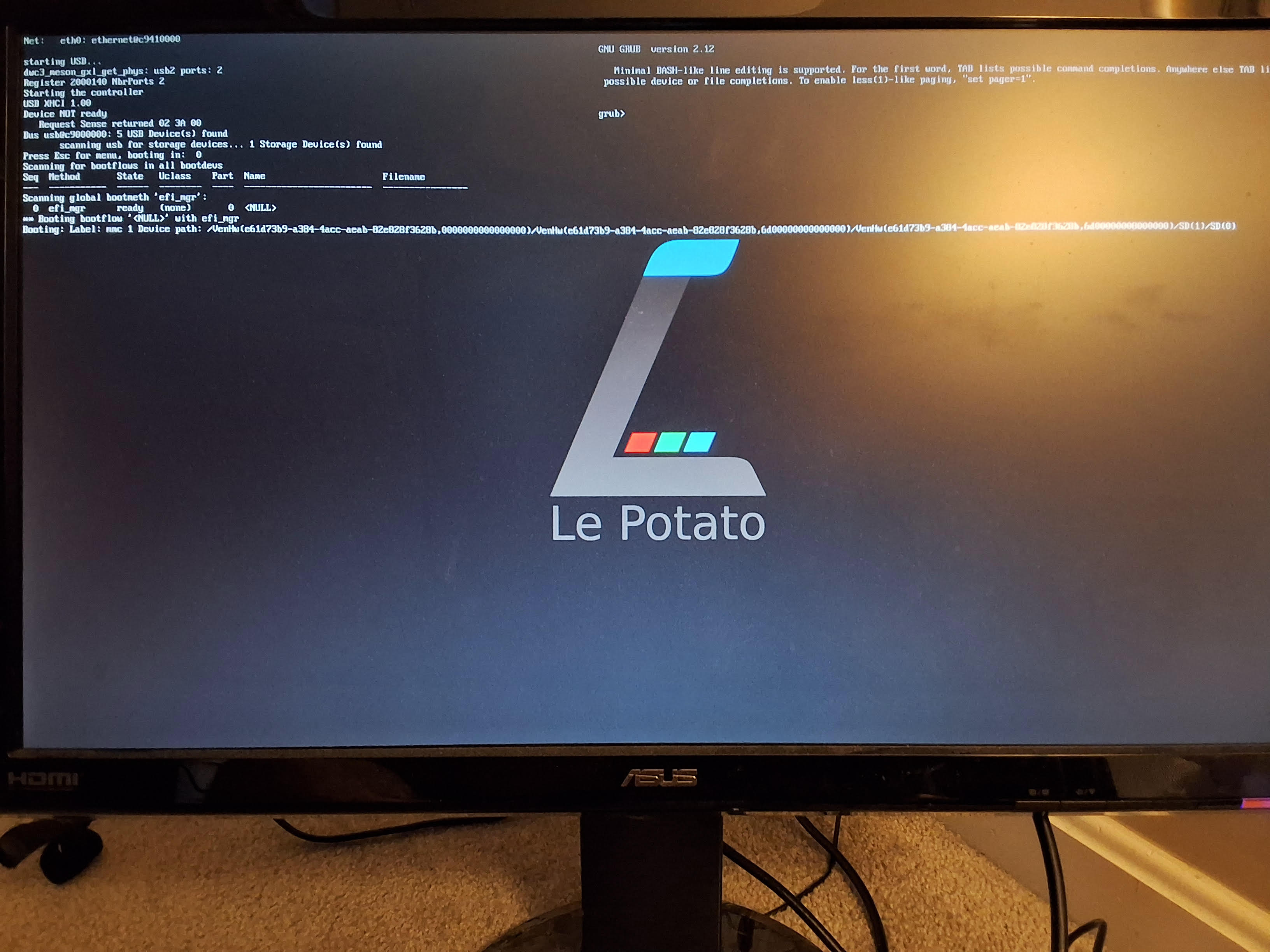

It doesn’t ‘auto’ boot, it loads grub, efi_mgr scans and finds none, there’s a line about bootflow ‘’ and then booting with and dumps me on the grub command line.
From reading and errors I get it wants a kernel, what file is that? The first 2 partitions have:

Can you post a photo or a few photos of the boot error? It will help us let you know what the issue is.
re-reading it, I don’t really see ‘error’ as much as, ‘found something bootable and NULL came up’
Type normal in the grub console and see if it goes through. If not, grub is broken on the HA image.
Seems broke then or I’m using the wrong image.
