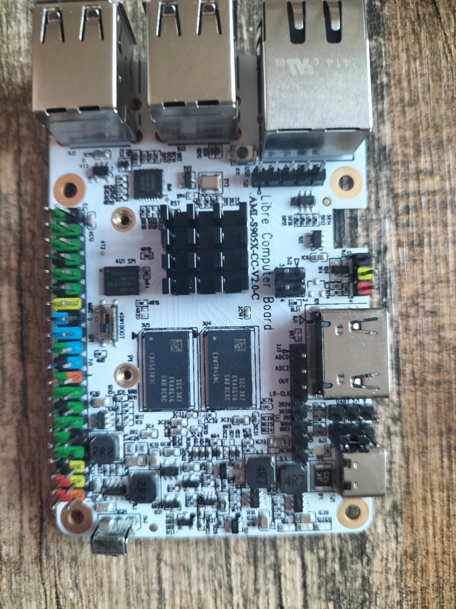

What kernel version? What’s the exact error from memtester? Photo of your board?

Photo Board:
I am only allowed to use one picture per post so this is the one from the top:

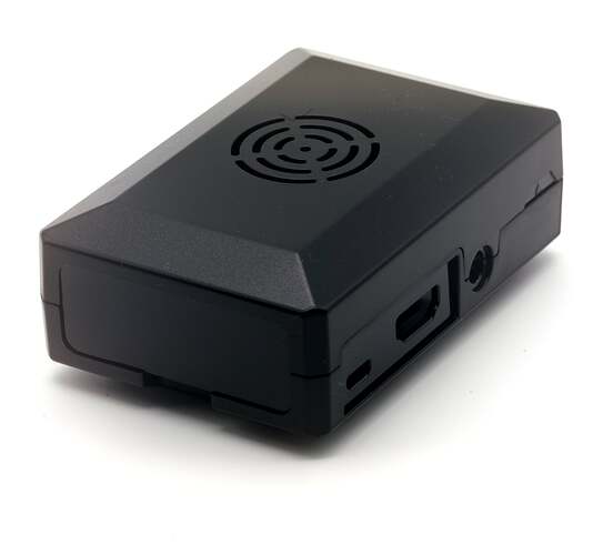

The board has been in this case since I got it:
Set the fan up with the help from:
If you need more pictures please let me know!

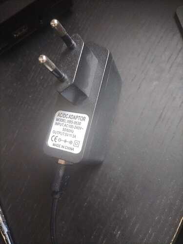

Powersupply:
AC/DC ADAPTER
MODEL:XBS-0530
INPUT:AC100-240V~
50/60Hz
OUTPUT:5V⎓3A
EMI
As far as I know there isn´t anything nearby generating EMI.
